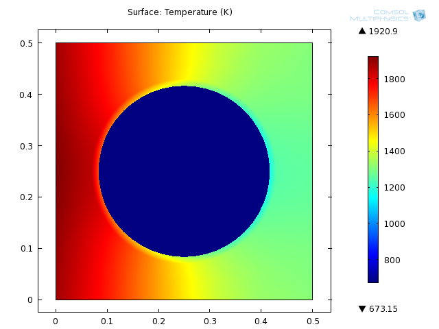

I am trying to simulate a fluid flow in a pipe and this pipe inside cubic box and this box is subjected to heat flux at upper half. I have turbulent flow. The heat transfer from the solid cubic box to the solid pipe to the fluid. I have two basic questions.
What is the different between Conjugate heat transfer and?non-isothermal fluid flow ??I believe that the conjugate heat transfer should selected when the heat transfer from solid to fluid. Please correct me if I am wrong
The second question I tried both of conjugate and non-isothermal fluid but the fluid temperature at the exit is around 450 c (inlet temperature is 400 c) although the pipe surface temperature is around 1600C. It should be more than that

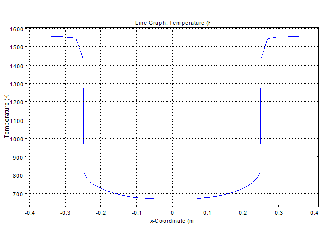

I do not have enough free time to reply just now, but clearly from the profile that I got by using a cut line on the outlet you have a steep gradient, so your fluid has a low heat conduction, or a high speed ;)
to calculate the average temperature you use the average operator on the outlet surface, but I beleive the T proile is more interesting. You add a Data set by right clicking on the data set node

Here is a suggestion. Use engineering correlations to calculate expected heat transfer coefficient based on Re & Pr numbers and then solve a simple problem that is similar enough to your situation (e.g. with constant wall temperature of 1600 C ) analytically. You might be surprised to find out that your liquid temperature increase really is small. Be careful to make the distinction between local and mass flow averaged fluid temperatures.
