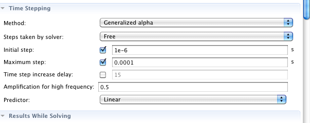

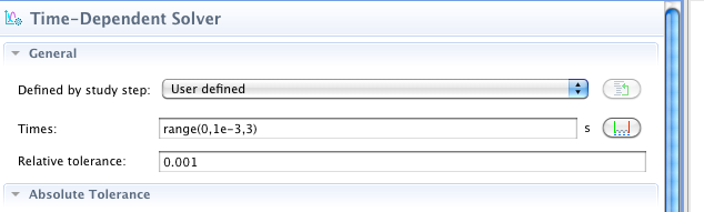

In the Times edit field of the time dependent solver setting, say, range(0,0.01,1.5), the 0.01 is the time step size in the computation or the output time in the simulation? It seems it is just the output time of the result since when I changes the value from 0.0.1 to 0.1, the computation elapse time does not change for the same end time 1.5. If I want to change the time step size in the computation, what should I do?
Thanks.
To add a bit more:
what you saw in the first picture is "output" time, which the model will save the solution to file. However what you see on the second picture is what solver does take, and that you can restrict. Overall, the picture 1 time does restrict the second time.
Say your output time is 1s, while your maximum solver time-step is 10s. The solver will effectively use 1s as timestep. But not the other way around.
Comsol 4.0a
Ubuntu 10.04.1

To add a bit more:
Comsol 4.0a
Ubuntu 10.04.1
